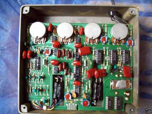

Above is a Ross Stereo Delay, using the less-common Reticon delay chips... Tuesday Guts!
Now, to tie that in to my argument, the only real difference between a bucket brigade and a digital chip performing a delay function is that the bucket brigade chip is probably sampled much more slowly (maybe 8khz at the slowest vs 44.1+ khz), the BBD introduces some distortion, noise and loss, and there is some kind of minor round-off error in the digital circuit.  Now, as a result of those differences (really only the first two), an analog echo circuit gets a LOT of "wrapper" circuitry - in particular, some very heavy low-pass filtering, compression, and expansion.  In the end, the only difference that isn't due to the wrapper circuitry are the BBD nonlinearities, but my point of my original post was that the nonlinearities of low fidelity digital conversion were comparable, if not just as musical.  At any rate, it was nice to hear someone else discussing this difference!
