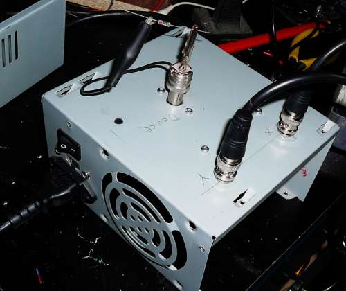

We have a new site hosted at Experimentalists Anonymous!  "Electron Coaxing Techniques and Notes" is an ever-expanding collection of information, tutorials and tips by forumite ve3wwg, aka Warren.  So far, there's a bunch of notes about different types of clipping as well as a steadily growing LTSpice tutorial.  Lots of theory accompanies practical advice for making new, interesting audio circuits.  Shown below is a diode tracer, which allows you to plot a diode's transfer function on an oscilloscope.
