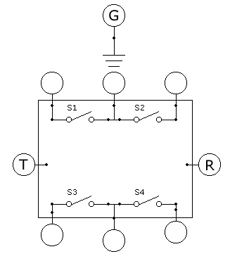

I'm doing an expression pedal out mod on my frequency analyzer after reading all of the awesome stuff people on this board are doing with them especially colin and spectral Julian. My question is this: I found what I believe are switched stereo jacks in my box-o-tricks, but they look much more confusing than the stereo jacks in the tutorial (they had been mistakenly shipped to me instead of open stereo jacks once). I cannot find data sheets for them. Here's a pic of these bad boys:
http://http://www.banzaieffects.com/product.php?productid=18634&cat=328&page=1
so my question (finally) is what are each of the terminals on the jack? Are these even switched jacks? The ring is easy enough to figure out. Did I mention I'm fairly new at this stuff lol?
I asked Colin about it and he suggested testing them with a multimeter. As I do not have a multimeter, I was wondering if there is another reasonable way to figure it out? Thanks for any help everyone. This site has kept me up late into the night many a time.

Hi Tim - it must be your lucky day. i found one of those "bad boys" and measured it
this is what you see when you are looking from the back and the ground lid is pointing up
there are four switches S1, S2, S3 and S4
when the plug is connected the switches S2 and S4 are closed.
when there is nothing plugged switches S1 and S3 are closed.
G stands for Ground
T for Tip
R for Ring

Thank you so much for the help dnny, that's awesome! I have one more question, just to make sure I don't screw up the mod. When doing this: http://http://experimentalistsanonymous.com/board/viewtopic.php?t=148
I want to keep the pot connected to the circuit at all times so I can set a min value for the expression pedal when it's plugged in. I want to connect the centre lug of the pot to the tip, and the other 2 lugs to the middle terminal on each side of the jack. Is this correct? Let me know if there is something worng with this:) Thanks for the help everyone!
